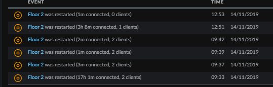

Однако, к сожалению, падения продолжаются.
6794
При этом "EVT_AP_RestartProc" не вижу нигде. Если я правильно понимаю, лог контроллера "<UserProfile>\Ubiquiti UniFi\logs\server.log":
[2019-11-14 12:50:55,968] <inform-65> INFO inform - from [80:2a:a8:7e:0d:70](Floor 2, BZ2, 4.0.54.10625): state=CONNECTED, ext/stun_ip=172.16.10.51, dev_ip=172.16.10.51, up=11310
[2019-11-14 12:51:10,047] <inform-75> INFO inform - from [80:2a:a8:7e:0d:70](Floor 2, BZ2, 4.0.54.10625): state=CONNECTED, ext/stun_ip=172.16.10.51, dev_ip=172.16.10.51, up=11324
[2019-11-14 12:51:22,109] <inform-72> INFO inform - from [80:2a:a8:7e:0d:70](Floor 2, BZ2, 4.0.54.10625): state=CONNECTED, ext/stun_ip=172.16.10.51, dev_ip=172.16.10.51, up=11336
[2019-11-14 12:52:48,869] <discover> INFO discover - [ignore] already in state CONNECTED
[2019-11-14 12:52:54,029] <inform-71> INFO inform - from [80:2a:a8:7e:0d:70](Floor 2, BZ2, 4.0.54.10625): state=CONNECTED, ext_ip=172.16.10.51, dev_ip=172.16.10.51, up=69
[2019-11-14 12:52:54,034] <inform-71> INFO event - [event] AP[80:2a:a8:7e:0d:70] was restarted (3h 8m connected, 1 clients)
[2019-11-14 12:54:00,875] <inform-78> INFO inform - from [80:2a:a8:7e:0d:70](Floor 2, BZ2, 4.0.54.10625): state=CONNECTED, ext_ip=172.16.10.51, dev_ip=172.16.10.51, up=47
[2019-11-14 12:54:00,891] <inform-78> INFO event - [event] AP[80:2a:a8:7e:0d:70] was restarted (1m 9s connected, 0 clients)
При этом в логе самой точки насчет рестарта нет вообще ничего.
контроллер 5.6.40, точка 4.0.54.
