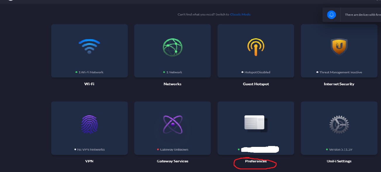

(Скрытые) настройки все на v2
  • Go into Settings
  • Change the URL from ../settings/site to ../v2/settings. This will take you into the new settings.
  • Once in new settings, click on Preferences

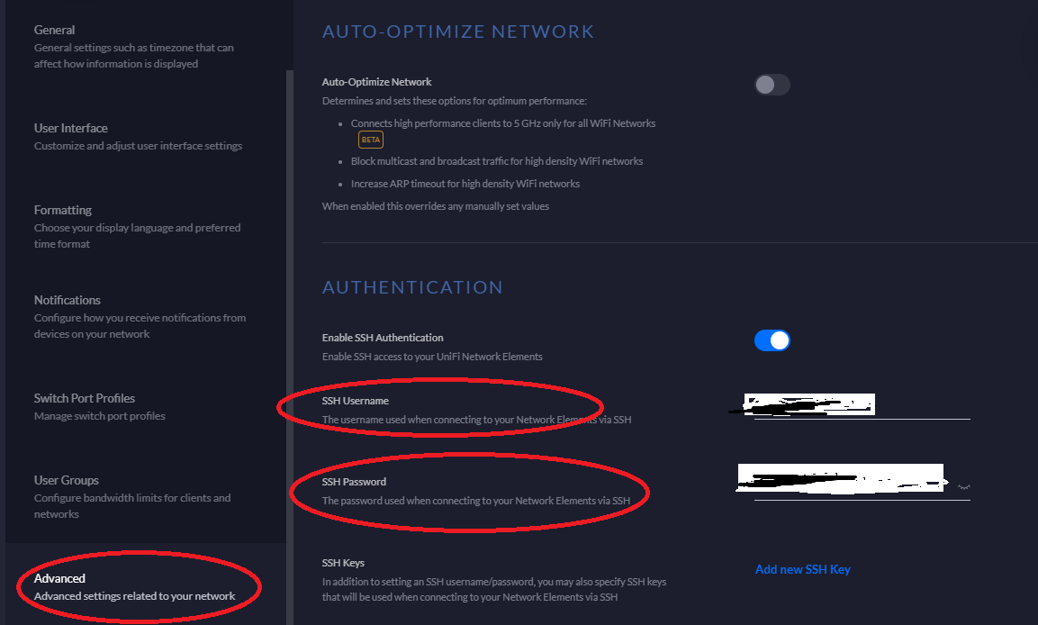

  • Scroll down on the left to Advanced, and click it
  • Scroll down on the right to the bottom to the Authentication section. You can reveal your SSH password there.
<sitename> - у меня default, у вас может быть другое.
https://ip.of.controllerl:8443/manage/site/<sitename>/v2/settings/
то что вам нужно тут - https://ip.of.controllerl:8443/manage/site/default/v2/settings/preferences/advanced
